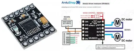

    Have you connected the "EEP" pin to anything? I'm assuming that this pin corresponds to the DRV8833's SLEEP pin (in the same way that 'ULT' probably corresponds to FAULT). According to the DRV8833 datasheet that pin has an internal pull-down, which will disable the device if left unconnected. – brhans Nov 09 '20 at 22:37
    A key problem here is that you are not asking about the chip itself, but rather about a mystery module, and so leaving key details of the chip connection unspecified. We might also ask if the module is correctly manufactured with the chip well aligned and soldered; we could even ask if the chip installed is actually a DRV8833 at all. – Chris Stratton Nov 09 '20 at 22:50
    @brhans you are right, it was the EEP pin. On this image I thought the jumper not been soldered, letting EEP unconnected would enable the device, but it was the opposite. – Onur Celebi Nov 13 '20 at 11:05

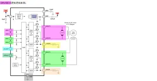

drv8833_block_diagram
drv8833 schematic

The OP has confirmed that he forgot to enable the DRV8833 by shorting the EEP (Sleep) jumper cap, therefore causing all zero's at output pins. I hope to make a follow up remark later, including a reminder for future readers and DRV8833 newbies.

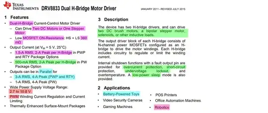

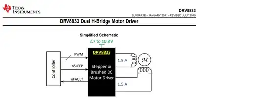

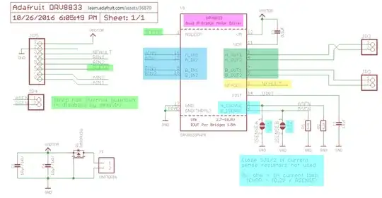

(1.1) To debug the motor driver, first thing first to read the following:
(a) Product sheet of the assembled breakout module to get a rough idea of the power requirements and function of the pin outs (which might be different from the chip datasheet.
(b) Datasheet of the chip, to get a rough idea of what external components are used to assemble the module.
(c) Schematic of the module.
To make the OP's question more specific, (a) to (c) above is appended to his question.

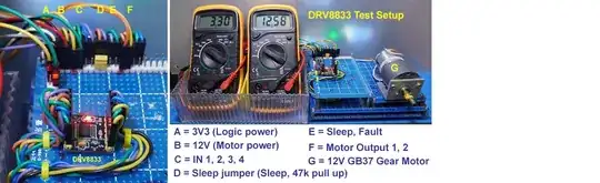

(1.2) Troubleshooting/Testing Plan
The OP seems to be a newbie in motor driver DRV8833. He might also not that experienced in using WiFi controller ESP32 to do testing and debugging. So I will try to explain my suggested troubleshooting procedure as simple as possible.
I will start without using ESP32, and do a manual testing, to make sure the module can output something, and not as the OP was worrying, overheating and fried the module while soldering the module pins.
I will also start troubleshooting without using any motor, because even though DRV8833 has flyback protection diodes to absorb any huge back EMF voltage/current spikes when the inductive coils of the motor is switched off.
Instead of the motors, I will use a series resistor and a status LED to indicate the motor switch is turned on or off. And I will test just one motor switch to start of, because if one motor switch works, the other motor switch should be very likely also OK. Now this is a summary of the test setup:
(a) Put away ESP32 and motors. We will just use jumper connecting wires and connect by hand to Vcc or Ground as input driving signals to the DRV8833 module.
(b) For the output side, connect a 1kΩ resistor with a LED across the terminals +, - (Bout1, Bout2, as indicated in the following Adafruit DRV8833 schematic) originally for output to drive Motor A.
(c) Now the input side. We will just entertain Motor A, and forget Motor B, and the current sensing inputs ASENSE, BSENSE. So, we will will use 5 jumper connecting wires AIN1, AIN2, SLP (Sleep), FLT (Fault) and GND (Ground). Of course we also need to connect the motor power VM.

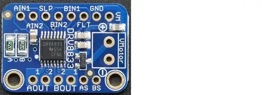

Appendix A - DRV8833 Overveiw by Lada Ada
Adafruit DRV8833 DC/Stepper Motor Driver Breakout Board Overview - Lady Ada
drv8833 adafruit
Spin two DC motors or step one bi-polar or uni-polar stepper with up to 1.2A per channel using the DRV8833.
  1. With DRV8833, you get 2 full H-bridges.
  2. This chip is better for low voltage uses (can run from 2.7V up to 10.8V motor power) and has built in current limiting capability.
  3. You set it up for 1A current limiting so you don't get more than 2A per chip, but you can also disable the current limiting, or change it to a different limit!
  4. The DRV8833 breakout has a polarity protection FET on motor voltage input.
  5. Each breakout chip contains two full H-bridges (four half H-bridges). That means you can drive two DC motors bi-directionally, or one stepper motor.
  6. Make sure they're good for about 1.2 Amp or less of current, since that's the limit of this chip. They do handle a peak of 2A but that's just for a short amount of time, if you turn off the current limiting.
  7. What we like most about this particular driver is that it comes with built in kick-back diodes internally so you dont have to worry about the inductive kick damaging your project or driver!
  8. You also don't have to worry as much about burning out the chip with overdriving since there is current limiting.
  9. There's two digital inputs per H-bridge (one for each half of the bridge), you can PWM one of the inputs to control motor speed.
  10. Runs at 2.7V-10.8V logic/motor power.
  11. The motor voltage is the same as the logic voltage, but logic voltage from 2.7V or greater will work so no need to worry if you are powering the motors from 9V and using 3.3V logic.
  12. For higher voltages, check out the TB6612. For much higher voltages and currents check out the DRV8871!

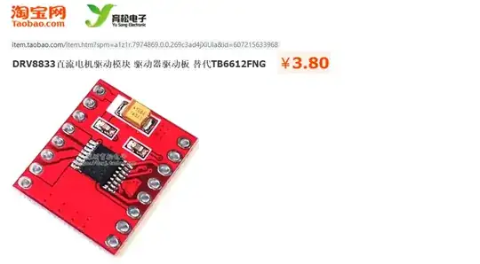

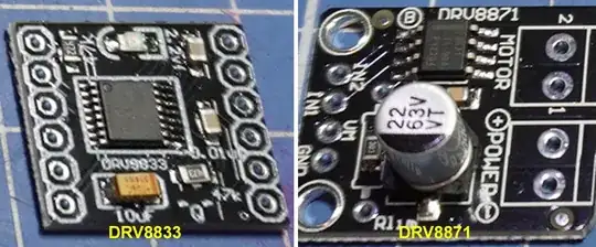

Appendix B - TaoBao/AliExpress DRV8833 Motor Driver Testing Notes
taobao drv8833 product
taobao_drv8833 module pin out

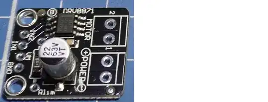

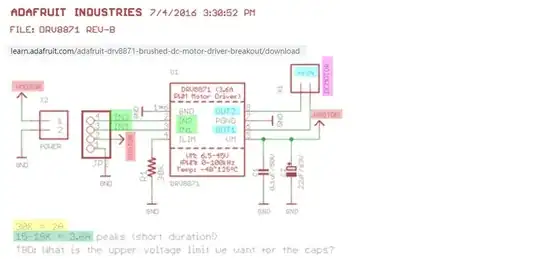

Appendix E - tlfong01's DRV8871 Testing Notes
Update 2020nov17hkt1458
The OP has confirmed that he forgot to enable the DRV8833 by shorting the jumper.
(This remark is out of date) I still have not received the OP's confirmation on the details of his hardware and software configuration. In the mean time, I found another question on DRV8871, so I am now diverting to DRV8871, and would come back when the OP replies.

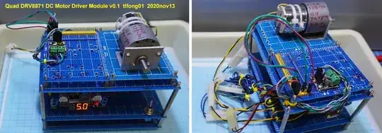

drv8871-1
drv8871 schematic
drv8871 v0.1
/ to continue, ...
