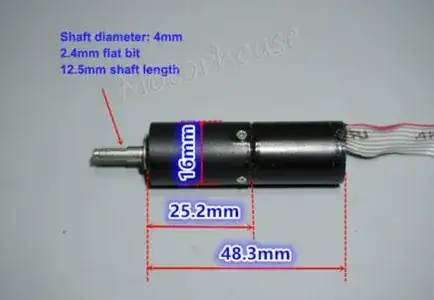

Small brushless motors with integrated gearboxes are readily available, but 'professional' units are very expensive. As an alternative you could look at surplus motors sold on eBay, eg. this one which outputs 38 rpm on 5 V (the motor itself runs at over 10000 rpm, while the gearbox has a ratio of ~220:1).
Now the only question is, how can we calculate the torque this motor can produce and what current is required to do it? That's a bit tricky in this case because we don't have the required specs (rated current draw or power). However we can easily estimate the motor's torque 'constant' (Kt) because it is simply the inverse of the velocity constant (Kv). We have a Kv (including gearbox) of 38 rpm / 5 V = 7.6 rpm/V or ~0.8 rad.s-1/V. Inverting that we get 1 / 0.8 = 1.25 nm/A.
This motor draws ~0.14 A with no load, so assuming it has reasonable full load efficiency the full load current should be several times higher. So for example at 0.3 A there should be 0.3 - 0.14 = 0.16 A of torque current, producing 1.25 * 0.16 = 0.2 nm of shaft torque. A 2 cm diameter gear would deliver 0.2 / (0.02 / 2) = 20 newtons or ~2 kg of linear force to the track.

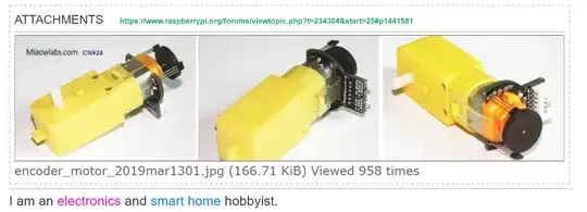

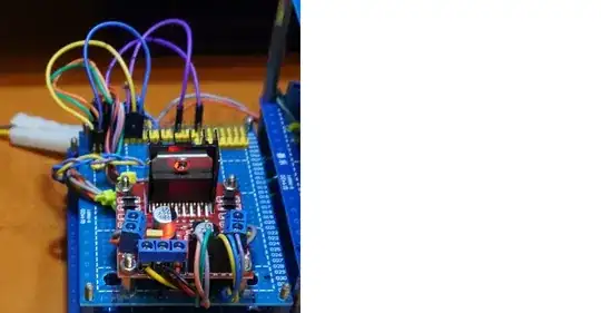

  3. For newbies, I would suggest to start off experimenting (submerging/drowning them in water! :)) with the very cheap and popular L298N motor driver (Appendix A), and the TT130 yellowish toy motor (Appendix B).

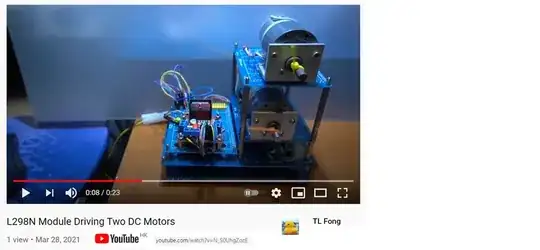

(3) L298N Module Driving Two DC Motors - tlfong01 2021mar28

Appendix A - L298N Motor Driver
l298n 1
l298n 2

TT130 Motor
