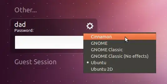

You should be able to install Cinnamon just fine in Ubuntu. You can install it with these commands.
sudo add-apt-repository ppa:gwendal-lebihan-dev/cinnamon-stable
sudo apt-get update
sudo apt-get install cinnamon
After installing you need to select it at the login screen to use it.

Whatever flavor of Ubuntu you start out with (Ubuntu, Kubuntu, Xubuntu, Lubuntu, Edubuntu, Ubuntu Studio, Mythbuntu), you can always install a different desktop environment to get the interfaces and applications associated with another one. So if you started with Ubuntu and installed lubuntu-desktop Install lubuntu-desktop, you'd get the Lubuntu interface and applications installed, and could select Lubuntu Desktop as your session type on the login screen (while still being able to use Ubuntu's regular interface and apps).
Cinnamon and MATE are two other desktop environments, originating in Linux Mint but not specific to that OS. There's no special Ubuntu derivative based on them, but you can install them in Ubuntu. The following situations are therefore basically equivalent in terms of functionality and performance:
  • Installing Cinnamon (or MATE) on Ubuntu and selecting Cinnamon (or MATE) as your session type.
  • Installing Cinnamon (or MATE) on a combined Ubuntu/Lubuntu system (i.e., Ubuntu with lubuntu-desktop Install lubuntu-desktop installed or Lubuntu with ubuntu-desktop Install ubuntu-desktop installed) and selecting Cinnamon (or MATE) as your session type.
  • Installing Cinnamon (or MATE) on Lubuntu and selecting Cinnamon (or MATE) as your session type.
Whatever interfaces you start with, Cinnamon (or MATE) will run the same way when selected (barring any bugs). It should perform the same on Lubuntu as Ubuntu--no better, no worse.
