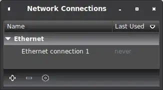

I have no experience configuring network manager by text configs, used only GUI. When moving mouse over NM tray icon there are tooltip "Not connected", however I see one connection then clicking it - "Wired unmanaged". Internet working fine.
I make new ethernet connection with priority 10 but it not appear in NM applet menu. plugin menu enter image description here

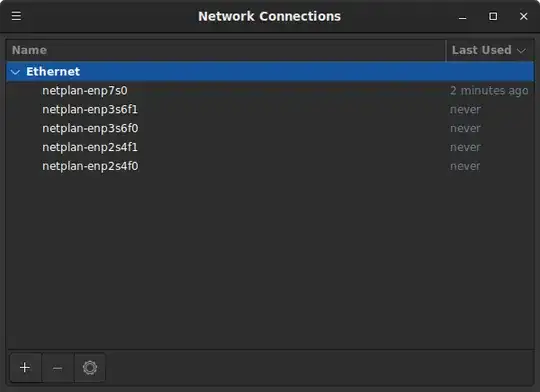

I had the same problem on Ubuntu 22.10 server with Unity based Cinnamon desktop.
I did as follow (based on @heynnema's answer):
  • /etc/network/interfaces did not exist, so I created it with inside:
    auto lo
    iface lo inet loopback
  • I did'nt found 01, but 00-netcfg.yaml instead in /etc/netplan/.
I just edited it as by adding "renderer: NetworkManager":
(other devices not used yet - only one is dchp for internet)
network:
  ethernets:
    enp2s4f0:
      dhcp4: false
    enp2s4f1:
      dhcp4: false
    enp3s6f0:
      dhcp4: false
    enp3s6f1:
      dhcp4: false
    enp7s0:
      dhcp4: true
  version: 2
With as results for all of my devices after the netplan apply command:
cinnamon-network-manager
