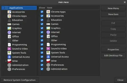

The Cinnamon menu comes with a reset option called "Restore System Configuration". But this doesn't set it to match with the available applications on the system. It rather reset it to the default shortcuts the Cinnamon menu should have on its install, seems to me.
Cinnamon Menu Editor

  1. I right-click on the Cinnamon menu to select "Configure..."
  2. I can click on the option-button (top-right corner - 3 lines button)
  3. Select "reset it to defaults"
Results in:
  • Wine shortcuts not automaticaly removed after uninstall of the wine application
  • All other application not present aren't represented.
  • All installed application are present like it should.
This is a solution to me.
