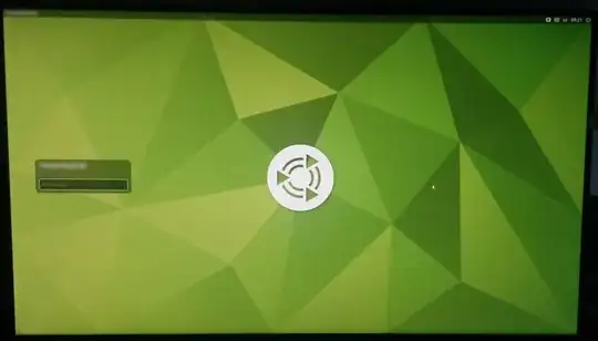

I'm running Ubuntu MATE 20.04 on one of my machines, and noticed that for some reason, it appears to be using two different greeters. It looks like LightDM for the login screen, but something else for the lock screen. How can I change it to be consistent? (And preferably use LightDM on the lock screen so that the power options are available)?
Login:
Lock:
The first greeter is LightDM with corresponding theme.
The second is the screensaver locker powered by MATE ScreenSaver. You can replace it with LightDM based one. Below is how.
