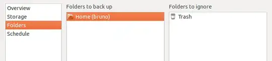

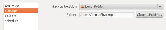

Make a backup of your home folder with the integrated backup tool in Ubuntu, Deja-dup.
  • Set the backup folder
  • Verify that it will make a backup of your home folder and add any folders your might not want, like for instance the Trash folder

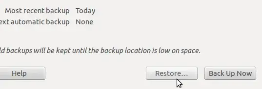

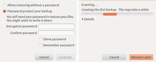

  • On the overview tab press Make Backup Now to backup your home folder
  • The backup tool will ask if you want to add a password to your backup, your choice. Your backup will start after you press Continue

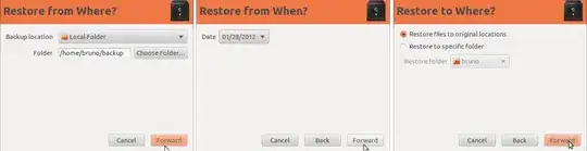

  • Open the backup tool and on the overview tab press restore
  • Follow the prompts to restore the files to their original positions
