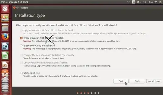

  3. You should see this image:
image of ubuntu upgrade dialog, source: https://sites.google.com/site/easylinuxtipsproject/upgrade
src: https://sites.google.com/site/easylinuxtipsproject/upgrade
--NOTE: Please don't choose the second option, i.e. the option crossed out in the image.
  1. The first option is the right one.
