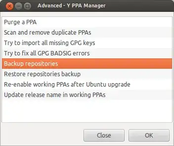

You could also use y-ppa-manager or you could use apt-clone to do that.
Here's a screenshot:
Y PPA Manager
https://launchpad.net/y-ppa-manager
