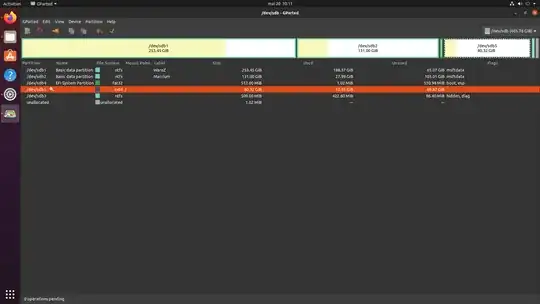

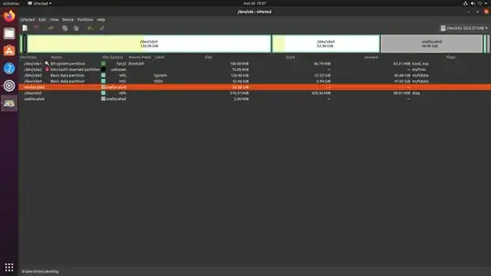

I know clonezilla would work if I was moving to a clean drive, but that's NOT what I want to do.
The reason I'm having a problem is simple: I installed Ubuntu and told it to "Install alongside windows" to make my life faster. In fact it ignored all the 50GB of unallocated space in Drive 1Drive one after install and instead installed Ubuntu to drive 2: drive 2
I mean, I won't even rant about this. I'm just super frustrated because I need both on the same drive and reinstalling would consume a lot of time, since I already spent hours to set it up, all programs, everything.
any ideas?
