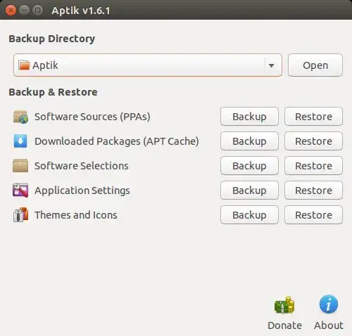

Aptik is really good. By using it and Deja-Dup I have just blown away a system (on purpose) and recreated it in only a hour or so.
Here's a picture of the Aptik screen.
I've used the first 3 buttons to save my configuration and reload it onto the new system. The 4th button seems to largely duplicate Deja-Dup's functionality, so I didn't use it. The 5th button I did not use because I don't have any custom themes or icons.
The only problem I have encountered is that a few applications didn't get moved and I had to reinstall them manually: Chrome, Teamviewer, Skype. I am not sure why this is, in fact I have been looking into that today. I noticed their ppas don't follow the same naming convention as most, perhaps that is why.
