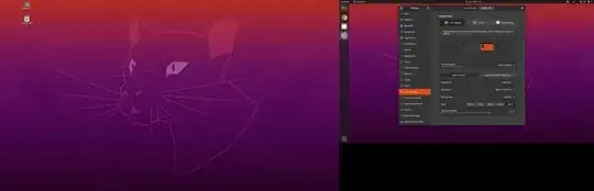

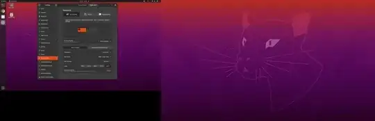

... and it works! I managed to extend my desktop except for one little problem: it's on the wrong side. Ubuntu puts my secondary monitor on the left hand side of my primary monitor, while it's the opposite on my desktop.
No problem in Screen Display, I drag the display #2 to the left hand side instead, except that doesn't work. When I do that, my external monitor (on the left hand side) is a black screen where I can only move my cursor around and blind click on things. Funny enough, screenshots work fine!
The picture above is a screenshot of my current situation and what I want to see! But in reality, I only see a black screen with my mouse cursor. This drives me insane, why would it work on one side and not the other?!
