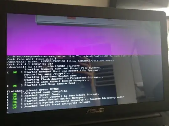

E.g. I ran "fcsk": This showed up and then the laptop was stuck (pressing enter did not help), also note the first line, that "/etc/default/rcS" was not found: fcsk

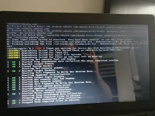

When I enter into the root console, after some time this shows up: failed boot for /boot/efi

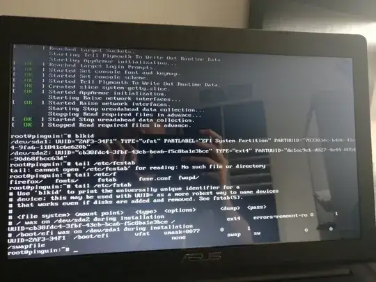

Here is the output of blkid and content of /etc/fstab: fstab and blkid

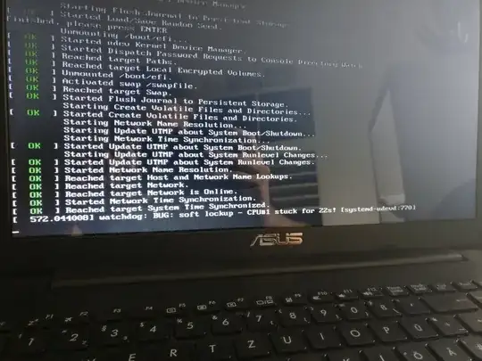

What I also tried was running "dpkg". This this showed up and it was stuck as well: dpkg

Update #1:
  • boot to recovery mode
  • choose root access
type:
sudo mount -o remount,rw /        # to remount the disk r/w
sudo cp /etc/fstab /etc/fstab.BCK # backup the file first
sudo pico /etc/fstab              # edit the file
change:
UUID=2AF3-34F1 /boot/efi vfat umask=0077 0 1
to:
UUID=2AF3-34F1 /boot/efi vfat defaults 0 1
reboot the computer
