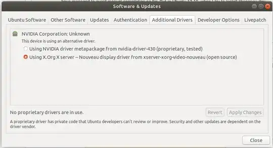

My drivers for NVIDIA the generic X.Org, so I try to install nvidia's proprietary drivers. I open the following image:
So I select the button for using nvidia-driver-430.
The problem is that after re-booting I end up with the problem described here: clean, n/n files, n/n blocks
I correctly fix this by running sudo apt-get purge nvidia* on recovery mode. However, I end up with the drivers not being installed again. Running sudo ubuntu-drivers autoinstall gets the problem again.

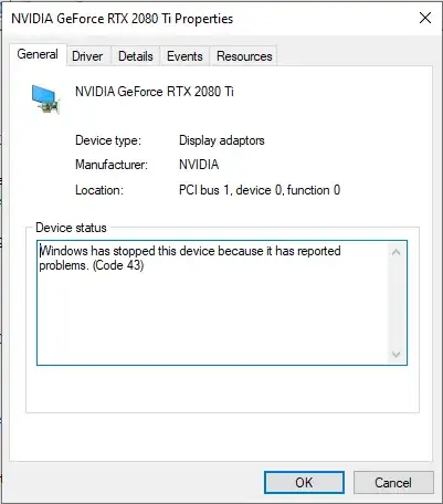

I installed windows to see if it was a problem with Ubuntu. However in windows is also not working properly. I have the following on "Device Manager":
I went to the official Windows support and do the following: If I try to update driver it says the correct driver is already installed. If I try to uninstall and then "scan for hardware changes" the OS crashes and reboots.
I found a Nvidia NVS 315 in my office so I plugged it to see if it worked. I booted in windows and it's now working as charm.
So the problem was either a driver/OS problem or hardware.
For that I tried it on Windows. As the board didn't work on windows I concluded it was a hardware problem.
Now it can be either the motherboard or the GPU, so I tried another Nvidia GPU and worked so the most likely conclusion is that my GPU (GeForce 2080) was faulty.
