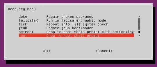

  4. After choosing the remount option, the menu comes up again. Select:
    root       Drop to root shell prompt
