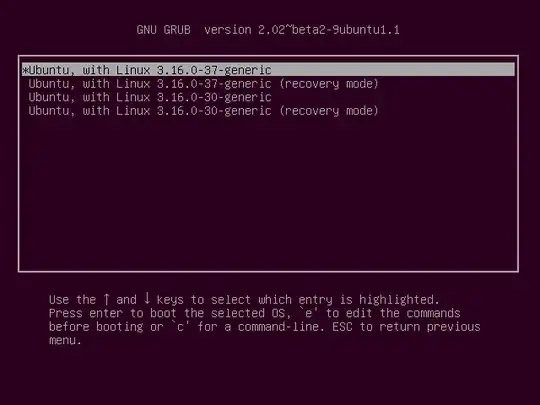

Hold down the shift key and you will be greeted by the "grub" menu (it looks similar to the image below). Next, select the second option on the grub menu:

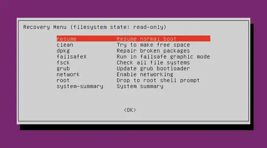

Once you selected the second option on the grub menu, you will see another menu with several recovery options: enter image description here
Select the "root" option. then you will see a root terminal-prompt like this:
