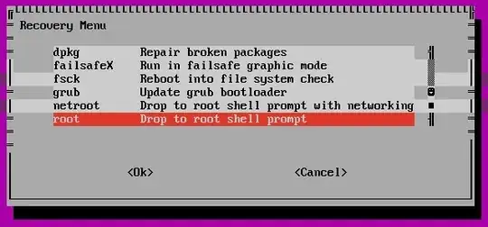

Hold SHIFT right after BIOS posts. That should get you into the GRUB menu regardless of whether your GRUB_HIDDEN_TIMEOUT is set to zero or not.
From the GRUB menu, select your most recent kernel tagged with "(recovery mode)". Once that finishes loading, you should be presented with a menu that has an option to "drop to root shell prompt". You might have to arrow-down to see it.
recovery menu
That should get you to the command line as the root user. From there you should be able to re-add yourself as a sudo user. Note that you might have a read-only filesystem at that point. If so, run the below command:
mount -o remount,rw /
