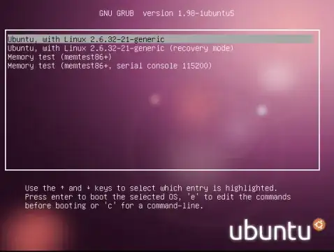

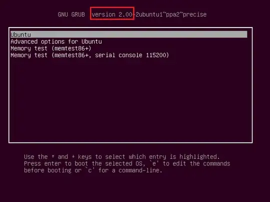

  1. While booting, hold Shift to access grub2's menu
  2. Select Advanced options for Ubuntu and hit Enter
grub2-1
  1. Select your current kernel's recovery mode (e.g. Ubuntu xx.xx x.xx.xx-xx-generic (recovery mode)) and hit Enter

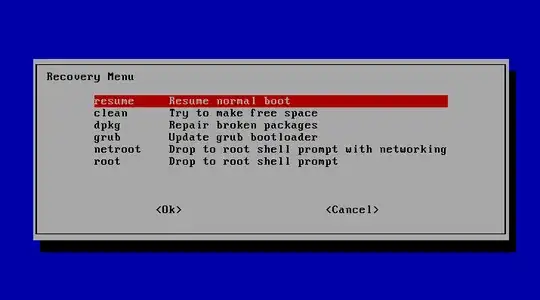

  1. Select root - Drop to root shell prompt and hit Enter
Recovery menu
  1. Run mount -o remount,rw / to remount the root partition as read-write
  2. Run nano /etc/group
  3. Look for the sudo entry and add "jonathan" right at the end
  4. Hit Ctrl+x, y and then Enter to save the changes
  5. Run exit
  6. Select resume - Resume normal boot
