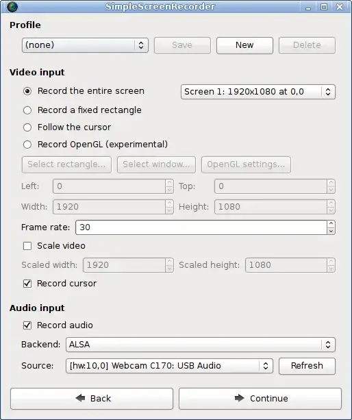

The app that I use and love for game-play recording is SimpleScreenRecorder.
It's low on resource-use, and records video and sound, and as its name suggests it's very simple to use.
To install simpleScreenRecorder go to a terminal by pressing ctrl+alt+T and run these commands:
sudo add-apt-repository ppa:maarten-baert/simplescreenrecorder
sudo apt-get update
sudo apt-get install simplescreenrecorder
note if you want to record 32-bit OpenGL applications on a 64-bit system run this command too:
sudo apt-get install simplescreenrecorder-lib:i386
Note2 the openGL recorder is still experimental but runs very smoothly and with no problem.
