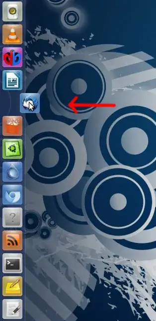

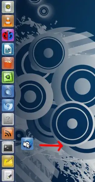

33
How to rearrange icons in Unity Launcher?
Just drag the icon out of the Launcher.
And then just drop it back in the Launcher anywhere you want.

You will need to drag the icons out of the launcher (right direction) and then place them wherever you want them to be positioned.

Yes. Click and hold a launcher. Pull it out to the right so it detaches. Drag it up and down and watch the little marker in between the other launchers. When you let go it will insert where that marker is.
