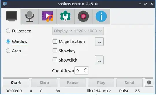

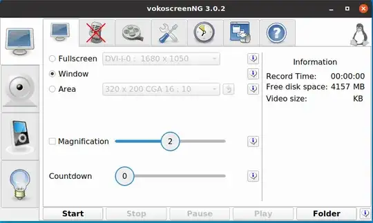

It is because of it is obsoleted and currently not supported. You could install it by enabling some older repository (deb http://cz.archive.ubuntu.com/ubuntu eoan main universe for example) which contain it or download its packages from there. Enabling other ubuntu version repository should be immediately disabled just after installing. But it is a bad way which could break your system. Better use newer supported software.
Vokoscreen records a desktop, a window and an area:
sudo apt install vokoscreen
Or use vokoscreenNG:
sudo apt install vokoscreen-ng
