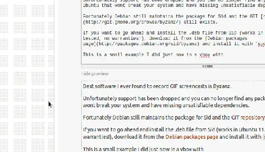

Byzanz
Best software I ever found to record GIF screencasts is Byzanz.
Byzanz is great because it records directly to GIF, the quality and FPS is impressive while maintaining the size of the files to a minimal.
Installation
Byzanz is now available from the universe repository:
sudo apt-get install byzanz
Usage
When it is installed you can run it in a terminal.
This is a small example I did just now with
byzanz-record --duration=15 --x=200 --y=300 --width=700 --height=400 out.gif

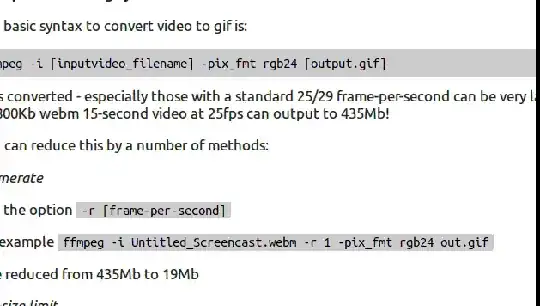

ffmpeg (install)
One of the best tools I use is ffmpeg. It can take most video from a screencast tool such as kazam and convert it to another format.
Install this from software-center - it is automatically installed if you install the excellent ubuntu-restricted-extras package.
Kazam can output in the video formats mp4 or webm. Generally you get better results outputting in mp4 format.
Example GIF making syntax
The basic syntax to convert video to gif is:
ffmpeg -i [inputvideo_filename] -pix_fmt rgb24 [output.gif]
GIFs converted - especially those with a standard 25/29 frame-per-second can be very large. For example - a 800Kb webm 15-second video at 25fps can output to 435 MB!
You can reduce this by a number of methods:
Framerate
Use the option -r [frame-per-second]. For example
Size reduced from 435 MB to 19 MB

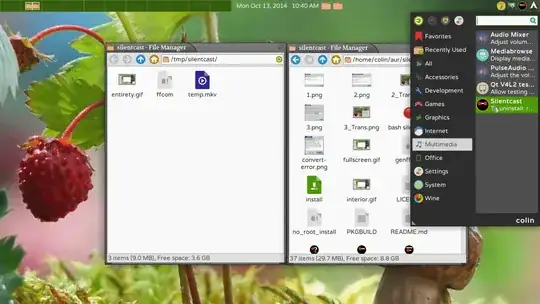

Silentcast
Silentcast is another great GUI-based tool for creating animated .gif images. Its features include:
  • 4 recording modes:
    1. Entire screen
    2. Inside window
    3. Window with decoration
    4. Custom selection
  • 5 output formats:
    2. .mp4
    3. .webm
    4. .png (frames)
    5. .mkv
  • No installation necessary (portable)
  • Custom working directory
  • Custom fps
Installation
If you want a regular installation and are running a supported version of Ubuntu you can install Silentcast by PPA:
sudo add-apt-repository ppa:sethj/silentcast
sudo apt-get update
sudo apt-get install silentcast
If you aren't running a supported version of Ubuntu (you should really upgrade!) you will need to download the latest version from the GitHub page and manually satisfy the dependencies (you can procure yad and ffmpeg from here and here respectively) or, if you are running a slightly more recent version such as 13.10 you could try downloading the .deb directly.
If you're using Gnome you might want to install the Topicons extension to make stopping Silentcast easier.
Usage
Start Silentcast from your desktop environment's gui or run the silentcast command in a terminal. Pick your settings and follow the on-screen prompts. When you're done recording you will be presented with a dialog for optimizing the final output by removing a certain number of frames.
For more in depth usage guidelines take a look at the README, either the online GitHub version or the local version stored in /usr/share/doc/silentcast with zless or your favourite editor.
Example

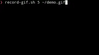

I created record-gif.sh, an improved version of Rob W's byzanz-record-region:
A lame GUI for byzanz, improved the user experience (mouse-selectable area, record progress bar, replay-able recording).
record desktop with shell
  • set recording duration ;
  • set save_as destination ;
  • select –with the mouse– the area to record ;
  • create a script to replay recording (cf. $HOME/record.again).
Install
I also created an installation script
curl --location https://git.io/record-gif.sh | bash -

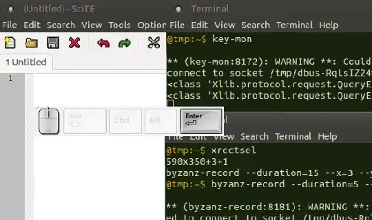

Ok, so in order to also capture mouse clicks, the only thing I found was key-mon (via the README of screenkey):
Then I:
  • Start key-mon
  • Use xrectsel to get the screen coordinates put into a byzanz command
  • Run the byzanz command

Note that key-mon --visible_click would draw a circle around the mouse pointer upon mouse click - which I would prefer, but in Ubuntu 14.04.5 LTS this is somewhat broken, as this circle does not appear and disappear fast enough in order to correctly illustrate the clicks (i.e. mouse presses and releases).

If you also want visible recordings of mouse clicks or key strokes, then screenkey is your best bet: https://github.com/wavexx/screenkey
