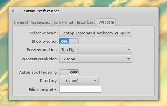

Kazam 1.5.3 was released recently and it includes some very useful new features:
  • support for webcams: it can record just the webcam or it can display the webcam in a window on top of the screencast;
  • support for broadcasting to YouTube Live;
  • added on-screen keyboard indicator and mouse click indicator;
  • new countdown timer.
Kazam is available in the official Ubuntu repositories, but it's an old version so it doesn't have the new features above. To get the latest Kazam in Ubuntu you can use the Kazam PPA.
Open a terminal and use the following commands:
sudo add-apt-repository ppa:kazam-team/unstable-series
sudo apt-get update
sudo apt-get install kazam python3-cairo python3-xlib
Source: http://www.webupd8.org/2014/08/kazam-screencaster-gets-webcam-and.html

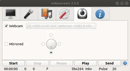

Kazam 1.5.3 has an option to capture webcam output while screen recording. Unfortunately, it is buggy.
A better alternative is to use vokoscreen. We can install it from software center or from terminal using apt.
sudo apt install vokoscreen
After launching it, you can enable webcam as shown in the picture.

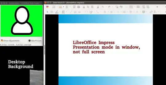

I did a workaround, as Kazam 1.5.3 was not available.
Software: I used camorama and LibreOffice Impress. Camorama is good, because it doesn't show toolbar.
First, on LibreOffice Impress set the presentation mode to Window In the menu Slide Show>Presentation Settings you can adjust to "windows". https://ask.libreoffice.org/en/question/159395/resize-presentation-display-window-to-less-than-full-screen/
Resize both WebCam viewer and LibreOffice windows, so both appear at same time.
You can use your slideshow with mouse/pointer/keyboard as in a normal presentation, while the Webcam is being show.
Not high-end, but it works. Example on my Computer
