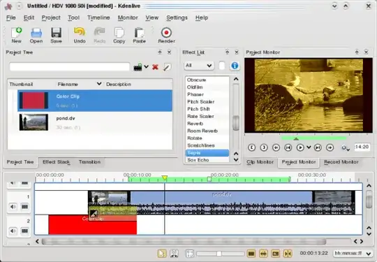

Kdenlive is a free open-source video editor for GNU/Linux and FreeBSD, which supports DV, AVCHD and HDV editing. Kdenlive relies on several other open source projects, such as FFmpeg, the MLT video framework and Frei0r effects.
Kdenlive is easily the best video editor currently available for Ubuntu. There is also a GTK frontend for MLT framework (OpenShot) but it has less features and worse user interface.
Kdenlive supports a wide array of video formats, images and transitions. The rendering tool has ready presets for most situations like Youtube, DVD, different mobile devices, etc. so you don't need to be an expert on video compression.
You can get it from Ubuntu's repository, but I'd suggest you get the latest version from project site. They even have a repository set up for Ubuntu.

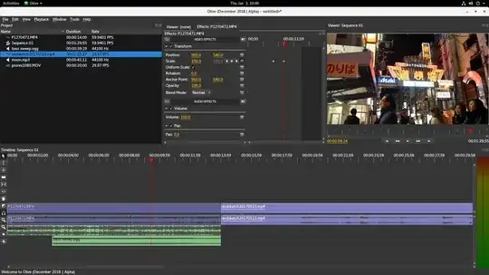

2020 update:
I think now the best option (even being on alpha) is Olive, IMO better than the alternatives.
Maybe a downside is that Olive targets professional users.
More general purpose.
Great video editor without need to install all the KDE stuff.
