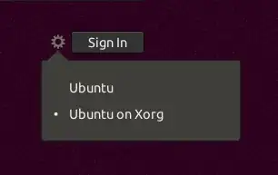

The only other chance you have to get the software you mentioned to work again is starting your desktop under Xorg as display-manager.
To do so you have to log out and use the cogwheel beside the sign in button to choose 'Ubuntu on Xorg'.
