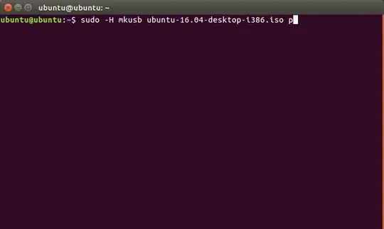

Run the command in terminal:
Run command in terminal

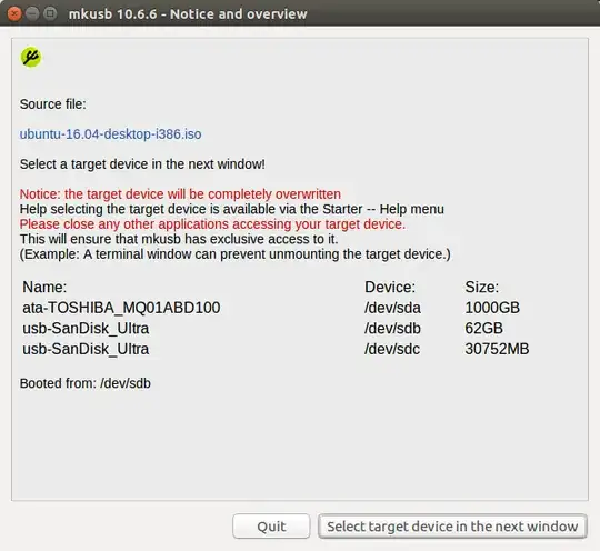

Click Select target device:
Click "Select target device"

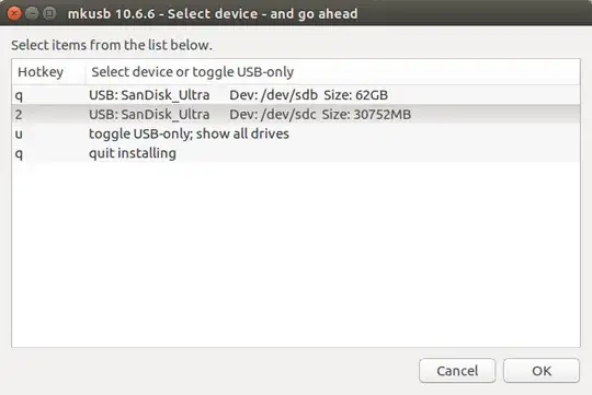

Click on the USB drive to make persistent. I want to use my 32 GB one so I double click on option 2:

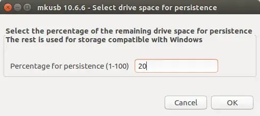

Enter a percentage of the drive to reserve for persistence. Mine is a large (32GB) so I allot only 20% ~ 6GB:
Enter percentage of drive for persistent files.

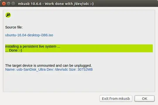

If all goes well you will be greeted by a nice green finished screen:
Finished Successfully
