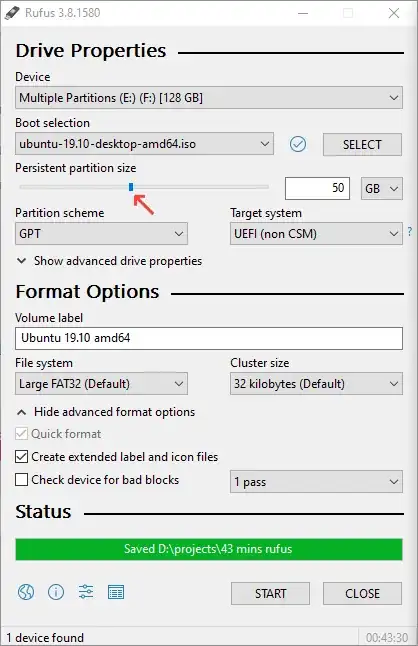

Rufus is able to create persistent live drives that work in both UEFI (MBR or GPT) and BIOS mode, with casper-rw being used for the persistent storage partition, so it can have a size of more than 4GB. Ubuntu Live ISOs created after August 1, 2019 support the persistent storage feature, so persistent partitions are only working with Rufus 3.7 and later using Ubuntu 19.10 and later. For best results please upgrade Rufus to version 3.9 or later.
Rufus persistent storage
