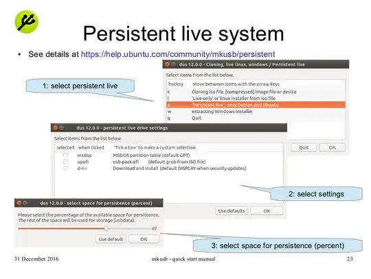

You can use mkusb to create persistent live drive. It creates a partition for persistence by default and automatically. The picture shows the steps in the wizard interface to create a persistent live system with mkusb version 12 alias dus.
See the following links for more details,
How do I make a persistent live USB of Ubuntu 16.04?
help.ubuntu.com/community/mkusb
help.ubuntu.com/community/mkusb/persistent
mkUSB-quick-start-manual.pdf
