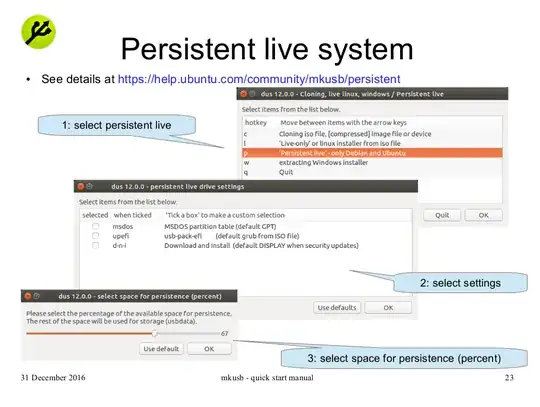

mkusb version 11 classic and version 12 alias mkusb-dus can create a persistent live drive automatically with all current Ubuntu versions and flavours, as well as with Debian Jessie.
mkusb uses a casper-rw partition
mkusb works with some linux distros derived from Ubuntu too. I have not tested with the newest Linux Mint versions, but it works with previous versions because the boot structure is/was similar enough to Ubuntu.
Install mkusb with the following command lines in Ubuntu and flavours of Ubuntu (Kubuntu, Lubuntu ... Xubuntu).
If you run standard Ubuntu, you need an extra instruction to get the repository Universe. (Kubuntu, Lubuntu ... Xubuntu have the repository Universe activated automatically.)
sudo add-apt-repository universe  # only for standard Ubuntu
sudo add-apt-repository ppa:mkusb/ppa  # and press Enter
sudo apt-get update
sudo apt-get install mkusb mkusb-nox usb-pack-efi
See these links,
mkUSB-quick-start-manual.pdf
help.ubuntu.com/community/mkusb
help.ubuntu.com/community/mkusb/persistent
help.ubuntu.com/community/mkusb/install-to-debian
Downloading and using mkusb-installer works with several other linux distros. Use one of the following links (and methods),
help.ubuntu.com/community/mkusb/gui#from_phillw.net
help.ubuntu.com/community/mkusb/gui/tarball

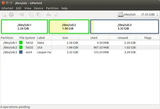

I just managed to achieve this with a LOT of help from this very helpful set of answers.
For reference, I was setting up a 16 GB Kingston Data Traveller with a custom ISO image that I had previously built using SystemBack.
The OS I am working on is Lubuntu, and my custom ISO had a lot of software package changes (I removed a lot of gumpf and installed some necessary utilities).
I started out by using araghuteja's very useful set of instructions and set up my device with three partitions:
  • 4 GB for the Windows accessible FAT32 partition (/dev/sdc1)
  • 2 GB for the OS (/dev/sdc2)
  • The rest (under 8 GB, but approximately that) as the casper-rw partition (/dev/sdc3)
This unfortunately didn't quite work, as just removing the casper-rw file from the OS partition isn't quite enough.
The real help was from Yu Jia Cheong, and StarBloom where they explain how to reset the GRUB bootloader to 'see' the casper-rw partition.
I did have to make some details that may make Yu Jia's instructions a bit clearer. (Please note, these instructions may not be fully appropriate for default Ubuntu ISO image as I think some of the file locations may be altered by the Systemback configuration).
Specifically - on Part 5, the file generated by
sudo update-initramfs -u
was named initrd.img-4.4.0-47-generic.
So - I copied this file to my 'casper-rw' partition, but then I realised that my GRUB boot menu looked was referencing /casper/initrd.gz (in four places) which resides within /boot/grub on the UUI partition.
So - I renamed my initrd.img-4.4.0-47-generic to initrd.gz, and replaced the file in UUI/boot/grub/casper/ (obviously retaining a copy of the old file just in case!).
Booted up with that particular USB stick and using df -h in the 'machine' root folder I get the following:
$ df -h
Filesystem      Size  Used Avail Use% Mounted on
udev             16G  4.0K   16G   1% /dev
tmpfs           3.2G  1.6M  3.2G   1% /run
/dev/sdb1       2.0G  1.3G  729M  65% /cdrom
/dev/loop0      1.3G  1.3G     0 100% /rofs
/cow            8.2G  118M  7.7G   2% /
none            4.0K     0  4.0K   0% /sys/fs/cgroup
tmpfs            16G  4.0K   16G   1% /tmp
none            5.0M     0  5.0M   0% /run/lock
none             16G     0   16G   0% /run/shm
none            100M   16K  100M   1% /run/user
/dev/sdb3       4.0G  4.0K  4.0G   1% /media/silver/DATA
/dev/sdb2       8.2G  118M  7.7G   2% /media/silver/casper-rw
I assume /cow is the casper live partition, and it is showing the correct size.
I find it interesting that I can actually SEE the casper-rw partition as /dev/sdb2 when I'm using the machine - is this correct??

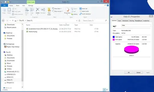

I'm also not convinced about the 3-way partitioning. In Windows(10) I can only see the OS partition, not the Data partition.
Many thanks to all, and I hope my experience helps someone else! (Note - I'm a sufficiently new to Stack Exchange usage that I can't comment - hence my answer is new, rather than a comment on Yu Jia's).
Update
I'm trying this again to create another 'Pen-Machine' and I've realised that the larger your ISO image, the more room you need to create for the casper-rw file when you run the UUInstaller.
My latest ISO image is something like 3.8 GB (it's a customised Ubuntu 16.04) and after three tries I have to create the initial OS partition at 5 GB and use a 1 GB persistence setting in the installer - otherwise you run out of storage when updating the initramfs functions.
Note - I finally resorted to setting the OS partition at 8 GB, just to make sure I had room!

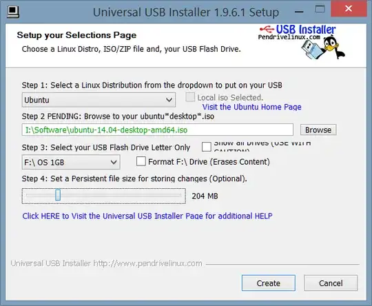

I did not have any problem creating the pendrive and booting it... Did you create the perndrive as follows?
The process involves 3 steps:
  1. Partitioning the pendrive.
  2. Making a bootable pendrive using Universal USB Installer.
  3. Adding Flags to the UUI partition and Completing the partitioning process.
Step 1:
Open GParted and partition the pendrive as follows-
Unallocated partition is added later in step3, sdc2 is for Ubuntu and sdc3 is for persistence. Since this is an 8GB pendrive, I used 3.32GB as persistent drive but will work with any size. Label this partition as casper-rw.
Step 2:
Insert the pendrive in a Windows Machine. The second drive (ie label-OS) will be detected. Install Ubuntu in this drive using Universal USB Installer.
Set a small persistent file, I used 204MB. The size does not matter since we'll delete it in step 3 anyhow. Press Create.
Step 3:
Insert the pendrive back in an Ubuntu System and alter the partition table as follows-
Now for the final part, Right Click on 2nd partition and select Manage Flags. Check Boot and lba.
Now you have a pendrive whose first partition will be detected in windows and a persistent drive that is larger than 4GB.
araghuteja
