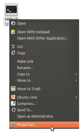

  1. Right click on your .sh file and select Properties:

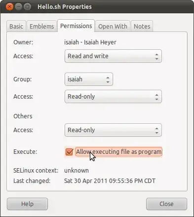

  2. In the Permissions tab, check Allow executing file as program:

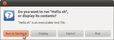

  3. Close the Properties window and double-click the file. A dialog will pop up giving you the option to run the script in a terminal:

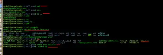

Go to the directory where the .sh file is by using cd. In this example I have stored my sh file as ~/Desktop/shell_practice/test.sh
first do pwd to figure out where you are, and if it returns /home/username (where username is your real username), you can run
cd Desktop/shell/practice
If you seem to be somewhere else, you can use the absolute path
cd ~/Desktop/shell/practice
or
cd $HOME/Desktop/shell/practice
or even
cd /home/$USER/Desktop/shell/practice
these are all ways of describing the same place. Once you've made it to the location of your script, type
ls
If you can see the sh file in the output, you can use chmod to make it executable. In my case, remember, the filename is test.sh, so I would run
chmod u+x test.sh
Now that we are in the same directory as the script, we have to specify to the shell that we want to execute the file by giving its location ./ (the current directory followed by a path separator, to distinguish it from the filename). To run my file I would type:
./test.sh
If your script has been written correctly it will run without errors...
