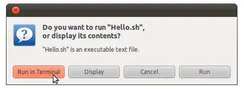

I want to run a .sh file in the Terminal. Apparently there is a pop up for that: pop-up window providing launch options for a shell script

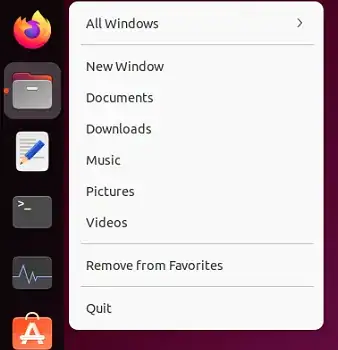

What I see when right clicking the "Files" program when it's closed:
If open this, this is what I see:

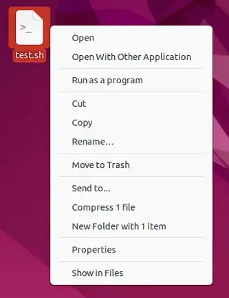

Right clicking on my .sh file looks like this, even after doing this command:
chmod +x meinscript.sh
"Run as a Program" doesn't open the terminal that I need.

Don't right click on the .sh file... Right click on the word "Files" in the top left hand corner of the Files Window. Then select Preferences, etc.

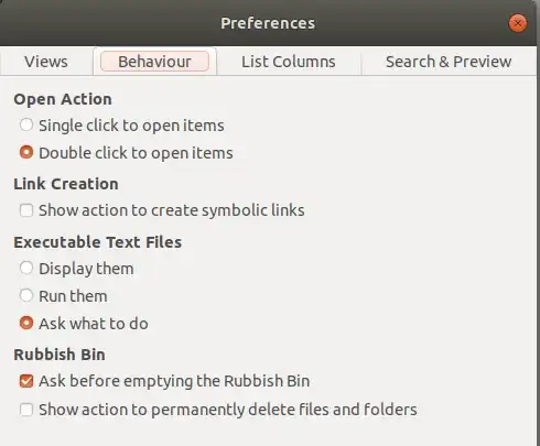

Click on this...
Right clicking on the above and clicking "Preferences" will load the following:

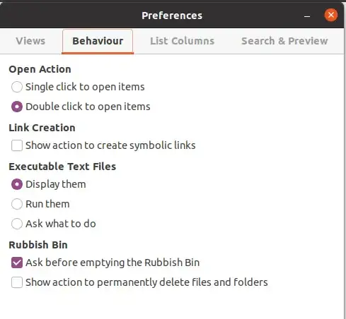

NOTE: The above is for Ubuntu 18.04, for 20.04 the same Preferences can be found in the button with the three horizontal lines as shown here:
Clicking on that and selecting "Preferences" will load the following window:
