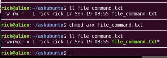

Let all users run your script
As stated you can set the execution bit of the file to make it executable with chmod +x. But you can also use chmod a+x:
$ ll file_command.txt
-rw-rw-r-- 1 rick rick 17 Sep 19 08:55 file_command.txt
$ chmod a+x file_command.txt
-rwxrwxr-x 1 rick rick 17 Sep 19 08:55 file_command.txt*
NOTES:
  • A script doesn't have to end with .sh it can end in .txt as shown here, or have no extension whatsoever.
  • Instead of just +x (only you can execute the script), use a+x so all users can execute the script.
  • The file name has a * appended to it to indicate it is executable. Also the file name changes color to green on most systems.
