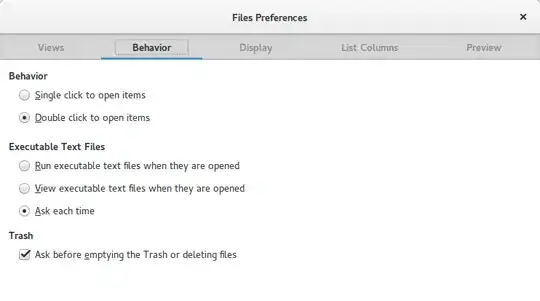

The property Allow executing file as program is not enough.
Change the settings in Nautilus Preferences
or via terminal:
gsettings set org.gnome.nautilus.preferences executable-text-activation ask
