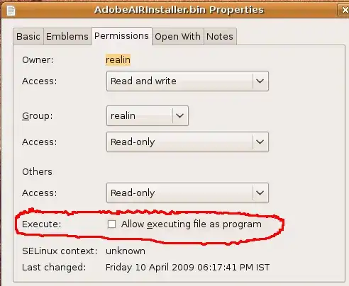

First you need to go through GUI, when you right click on the file and goto permissions tab then you get an option to make the file executable as in the picture.
and then you have two methods to install the game.
