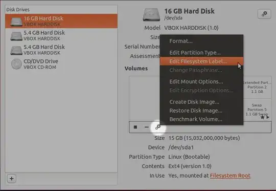

From the graphical desktop ( >= 12.10)
There is no need to run gparted only to give a partition a label. Just open Disks from the Dash:
Select the drive on the left panel and choose the partition to label in the volumes section. Then click on the highlighted area with the cogwheels for "More Actions" to reveal the menu shown above. This will let you "Edit Filesystem Label..." for the selected partition.

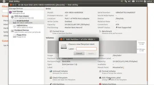

From the graphical desktop ( <= 12.04 LTS)
For release 12.04 LTS and earlier the application Disk Utility can be used for editing partition labels:
Note: after we had changed a label we may have to edit our fstab with the new label in case we mount disks by label.

I have recently confronted with the same problem as yours. I am using Zorin, an Ubuntu-based distro, and, every time when I have some problem to solve I turn to the Ubuntu or Linux Mint community in order to find the answer.
For me, the solution was easier than using gparted. I have used Disk Utility, which is pre-installed.
Start - All Applications - Accessories - Disk Utilities
Once opened, you click on the hard drive listed in the left side of the window, and you can see the partitions in the right side of the window. Click on every partition in order to select it (it will turn blue) then, in order to change the name click on the button named "Edit Filesystem Label", and thus you will be able to rename the partition. Do this operation with every of them.
Note that, if you are running Windows on your computer along with Linux, you will notice that the new label will show in windows too.
