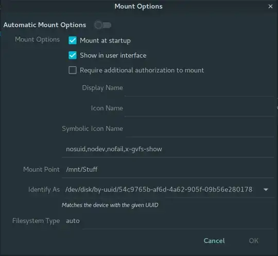

The easiest way to do this would be to do it with GUI
  • Go to disk app (through Unity Dash or terminal with gnome-disks command)
  • Choose your partition
  • Click the little gear icon Gear icon
  • Select Edit mount options
  • Toggle Automatic Mount Option to Off
  • Edit mount point to /media/ronin_cunningham/StorageDevice
On a side note, this will also enable your partition to be mounted automatically on start up, If you don't want that to happen then make sure to
  • Un-mark Mount at Startup
You'd want to do this if your Bootup times are slow
screenshot of gnome-disk app Theme might not look exactly like this
