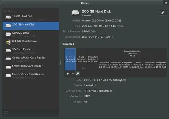

You can modify the mount options using the "Disk" utility. Open the Dash, type Disk, then enter. You will presented with a screen like this:
enter code here

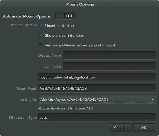

Select your partition of your HDD, then select the small cogs icon. You will have a screen like this:
Just turn off the Automatic Mount Options, and select the "Mount Point" where you like the drive mounted, etc.
