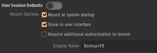

Another GUI way if you're using Gnome.
  1. run gnome-disks or search for "Disks" in the app search
  2. Choose the device
  3. choose the partition, click the gear icon
  4. Modify the Display Name field
