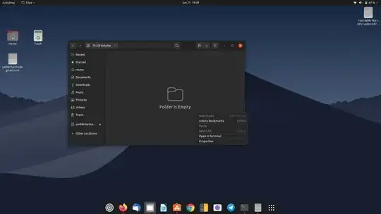

I am not able to copy or extract files to, and even create new folder in the a partition that I have.I am able to copy files to and do other things in the other two partitions but not in the third one. What to do? I have attached some screenshots for reference. Pl. help ASAP. Thanks in advance :)
Not able to extract files
Not able to move files to that partition
Not able to create new folder
You are working with Linux. Linux handles security through file ownerships and permissions. For file systems that support linux permissions, the permissions of the root folder are in effect. By default, owner is the administrator: root, and currently on Ubuntu, the permissions by default are +rwx for user, +rwx for group and +rx for others.
If you want to use the drive fully for your current user, then change the permissions of the mount point:
sudo chown $USER:$USER /media/aaditya/15e16d9b-fbe1-4d51-ade6-2d7b4e2F9a86
You see that I retrieved the information on where this drive is mounted from your screenshot.

The problem was fixed after I created a home partition out of that free space partition. Now I am able to manipulate and create files in that partition. Thanks for ur reply and comments. The link which I got help from -
