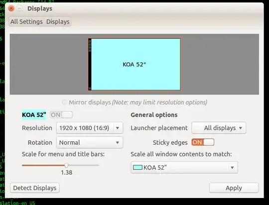

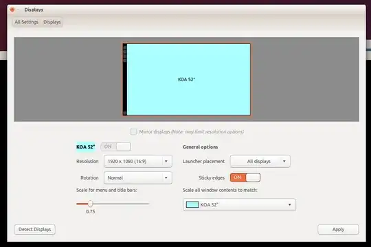

Starting with 14.04 we have an option that helps a bit:
Scaling Support
In the image below we can see the scaling it has at 0.75 on the fonts and title bars:
In the image below we can see the scaling it has at 1.38 on the fonts and title bars:

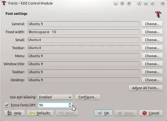

As far as my experience in Ubuntu goes, changing the font DPI setting changes a lot more than just the way fonts are rendered. It also applies to icons and the size of menus for example.
It's just that Xorg hints the Desktop Environment on what the physical display's DPI is. And yes, you can override this in the Xorg.conf, but it has the same effect as changing the setting in your DE. For example in Kubuntu/KDE:

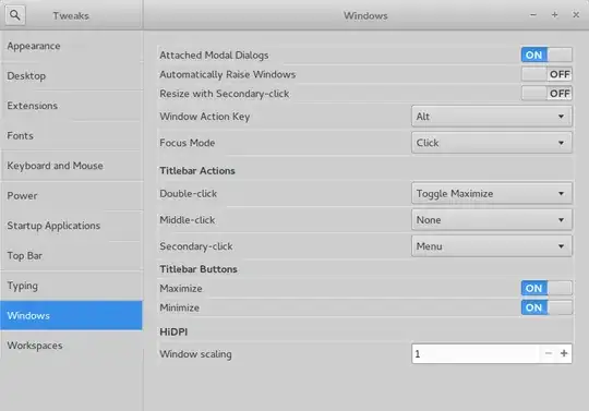

As I ended up on this question looking for windows HiDPI scaling in Ubuntu Gnome, here's my addition to random suggestions, so that I'll find it when I need it again. :)
To access this dialog, open Gnome Tweaks and go to Windows section.
Gnome Tweaks - Windows
