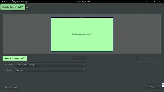

I just finished building myself a Ubuntu HTPC/Home server, and when I was setting it up, it was hooked to a 24" ASUS monitor using HDMI, no problem there, crystal clear image. But now that it's ready to roll, I've moved it to my TV (42" LG HDTV), still using HDMI for A/V link.
Here's my problem : my TV is identified by Ubuntu as a 7" screen, so the DPI is all messed up. I've tried looking online, and most people say it's an overscan issue, but I can still see all of the screen, it's just scaled terribly wrong :

After many research, this appears to be a bug in GNOME 3. This link offers a workaround, and while it's not perfectly sized, it's still an improvement from the previous scaling
