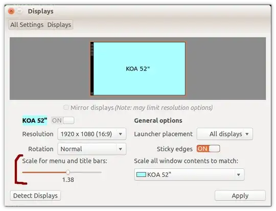

As display is on 42" TV and I am seating far, I cannot read. Is there any utility which can make screen more readable and we can work from far or any kind of work around.

It's quite simple actually - find the "Displays" utiltity in the dash,and drag the "Scale for menus and titlebars" slider to the right, which will make everything bigger:
Another possibility would be to lower the resolution, which would also make things bigger on-screen. A third possibility may be to change the DPI, but that's somewhat complicated.
(Credits to Luis Alvarado for the screenshot)
