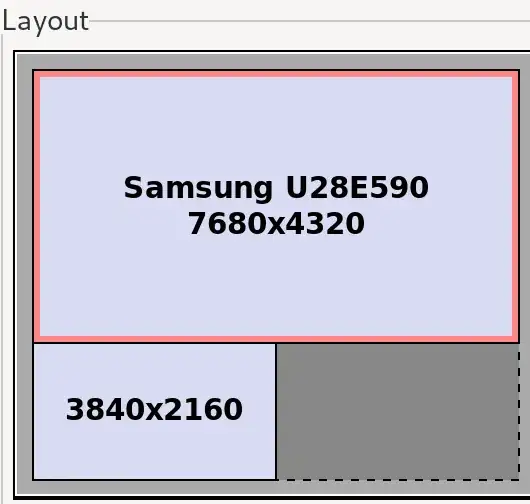

I had a similar problem and solved it this way.
I have an external big screen 24" 3840x2160 and a laptop same definition 3840x2160 but small screen 15.4"
I wanted the laptop screen to be zoomed because default scaling is too small ..
Scaling down with xrandr as we usually see results in blurry screen, the solution is to scale everything up with xrandr then use gnome scaling factor :
Here is how to do it (external screen on top of laptop screen but you can arrange in a different way if you change pos parameters)
xrandr \
    --output DP-0 --primary --mode 3840x2160  --pos 0x0 --scale 2x2  --rotate normal \
    --output DP-2 --mode 3840x2160 --pos 0x4320 --scale 1x1  --rotate normal \
    --output DP-1 --off
Explanations :
--output : DP-1 is the external screen, DP-2 is the laptop screen (use xrandr -q to get your devices names)
--mode : both screen have same definitions 3840x2160
--scale 2x2 for external, 1x1 for laptop, this is "relative" to the primary which is external screen here..
--pos : external screen is at position 0x0, laptop screen is bellow at pos 0x(2160*2)=0x4320 because external screen is scalled by 2
Then
gsettings set org.gnome.desktop.interface scaling-factor 2
OR
gsettings set org.gnome.settings-daemon.plugins.xsettings overrides "{'Gdk/WindowScalingFactor': <2>}"

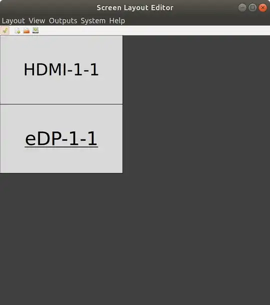

I spend hours to solve this issue. I have a 4k laptop and 1080p external monitor. If I set scaling to "200%" external monitors displays enlarged icons text etc.
I tried xrandr commands with "--scale" but they didnt give me the expected results. So I have a xrandr command that works perfectly for me. I wish somebody else find it helpful.
xrandr --output HDMI-1-1 --mode 1920x1080 --pos 0x0    --rate 60.00 \
       --transform 2,0,0,0,2,0,0,0,1 \
       --output eDP-1-1  --mode 3840x2160 --pos 0x2160 --rate 60.00 --primary
This commands works as external monitor scaled to "100%" and built-in screen scaled to "200%". This commands places external monitor above the built-in. Keep in mind you probably will change --output names with yours.
Note that 2160 in --pos 0x2160 has nothing to do with the height of eDP-1-1 (it just happens by chance to be the same value in my case). That number is in fact the height of the upper monitor (1080 in my case) corrected by the transformation (so 1080*2 in my case).
This is because --pos refers to the position of the upper left corner in the virtual screen space, so the bottom screen has to be positioned relative to the height of the upper screen.
Finally, you can ignore --rate flags. The most important flag here is --transform. And positions depends on screen resolutions and placements. Using this commands I have a Arandr preview like this;
Arandr screenshot
1080p monitor is virtually adjusted to take up twice as much space. Thanks to monitors are perfectly aligned, when I move the mouse from one screen to another, it appears on same horizontal coordinate
