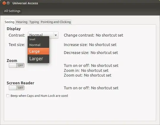

I changed the text from normal to small in the Universal Access settings, but then it was way too small.
I also tried it this way, but it doesn't appear to have any effect.

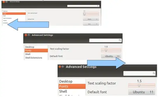

Gnome Tweak Tool
This is a common issue on the forums - the move to gnome3 has dumped many of the customisation features that were available in gnome2.
One GUI tool that exists in Software Center is gnome-tweak-tool - its a partial solution to allow you to customise some aspects of fonts.
The "Text scaling factor" is the option you are interested in - its unfortunate that it is a sliding bar so you will not be able to enter the actual DPI value. Click on the sliding bar and use the left/right arrow keys to decrease/increase the font size. enter image description here

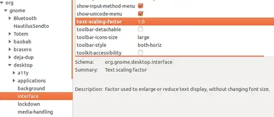

dconf-editor
Using dconf-editor which is available in the dconf-tools package allows you to set the "Text Scaling Factor" numerically i.e. changing the default value by fractions of numbers (1.2, 0.9 etc) changes the overall screen font size:
Universal Access
If you just want to adjust the text size universally without need detail you can do this from the universal access tool:

If the key text-scaling-factor is missing from gconf-editor, check alternatively:
 gsettings list-schemas | grep org.gnome.desktop.interface
 gsettings list-keys org.gnome.desktop.interface
 gsettings get org.gnome.desktop.interface text-scaling-factor
 gsettings set org.gnome.desktop.interface text-scaling-factor 0.9
(replace 0.9 with the desired value).
