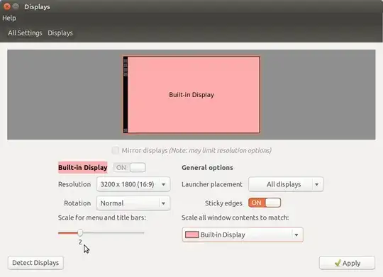

Starting with 14.04 we have an option that helps a bit:
Scaling Support
open the System Settings (here in english:)
LANG=c unity-control-center
Go to "Displays" and set the "Scale for menu and title bars":
