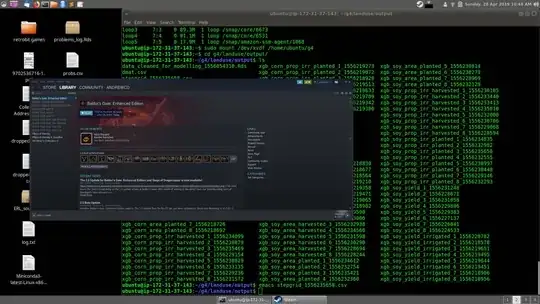

Have a look at this screenshot of my desktop: enter image description here
The resolution on Steam is tiny, but the resolution on the terminal is normal. Up in the upper right, different icons have different resolutions. The Steam icon is normal, while the dropbox icon is small.
When I plug in my external monitor, I can use xrandr to make the resolution 2650x1440. But I can't use the built-in GUI. If I hit the super key and type in "display", nothing happens. I suspect that this is related.
In fact, none of the settings come up.
What's going on here? Why do some windows follow one resolution and others follow another? Is it related to the inaccessibility of the settings GUI windows?
This all happened after a routine update that changed the look of Cinnamon slightly.

I don't believe that Ubuntu is compatible with 4k, I have been trying to configure it for several weeks and failed.
1) Configure some of the most popular applications to scale correctly on 4k high-dpi.
2) Follow this instruction to configure Ubuntu apps (spotify, steam and many other apps) for high-dpi
For your issue with steam I quote HiDPI Archive Steam page
Steam
Official HiDPI support
Starting on 25 of January 2018 in the beta program there is actual support for HiDPI and it should be automatically detected.
Steam > Settings > Interface, check "Enlarge text and icons based on monitor size" (restart required)
If it not automatically detected use GDK_SCALE=2 to set the desired scale factor.
