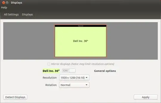

This is what the Displays config screen looks like this:
Note that there is no Scale for menu and title bars option, so nothing referencing that setting is applicable (such as the answers to this question).

Objects of your interface are too big because your resolution is too low. You've got large 30'' monitor and only 1920x1200 resolution (as I can see on your screenshot).
Open the "Resolution" dropdown menu - it should contain 2560x1600 setting (which has the same size ratio as your current one, i.e. 16:10). Select it and press "Apply". If the dropdown menu line with 2560x1600 is not the last, and your monitor is able to sustain even greater resolution, use it.
And then, when your resolution will fit the native resolution of your monitor, you can use the advice you've mentioned in your question to adjust the DPI of your monitor properly.
