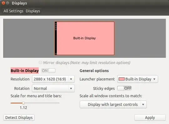

Version 14.04 of Ubuntu has some things that make this experience better. Go to: System Settings -> Displays. In the Scale all window contents to match: select "Display with largest controls" for bigger controls. You can also increase the Scale for menu and title bars (my setting is 1.12).
Text scaling factor in System Settings -> Displays

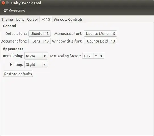

I have also had success with the Unity Tweak tool. This is as separate free program that you can install from the Ubuntu Software Center. Go to Unity Tweak Tool -> Fonts to change the sizes of the default fonts in Ubuntu. My settings are Default font: Ubuntu 13, Monospace font: Ubuntu Mono 15, Document font: Sans 13, Window title font: Ubuntu bold 13. Also notice that my text scaling factor is set to 1.12.
Unity Tweak Tools
With those settings you should be able to find a configuration that works for you. Post the settings that you find work better. I would like to see that!
