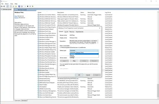

We can ask Windows to sync time with the network on every reboot:
  1. Search for "Services" from the start menu.
  2. Locate "Windows Time".
  3. Set "Startup type" to "Automatic". In my case, the time updates at about 10 seconds after logging in to Windows.
On Ubuntu, we can set "Automatic Date & Time" in settings, and by default, it runs on every reboot automatically.
This is my favorite approach as it does not require modifying the registry or setting Linux to use "local" time, which might have side effects such as daylight saving time synchronization.
