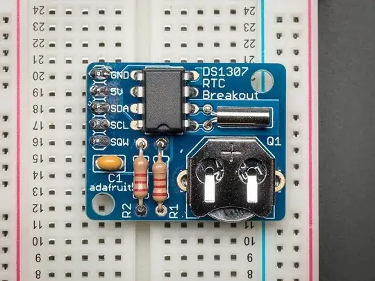

No, it would not go astray. There is a RTC (Real Time Clock) chip:

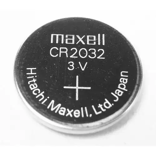

On the motherboard which is powered by, in my case, a CR2032 battery:
Even many laptops have an internal CR2032. I discovered that when I had to replace the CPU fan in one of my laptops. Since it was such a bear to take apart, I replaced it even though it wasn't dead :)
And yes, those batteries do die after 6+ years... (Of course, your milage may vary depending on how long the computer has AC power VS. running off of only that tiny battery.)

This is thanks to a small device inside your computer called a Real-Time Clock. It is usually powered by a small button battery and (usually) cannot be turned off except by physically taking the motherboard out and removing the button battery; therefore, no, turning off your computer would not make the clock go astray. The button battery does run out of power, but it takes a very long time (usually 10+ years).
